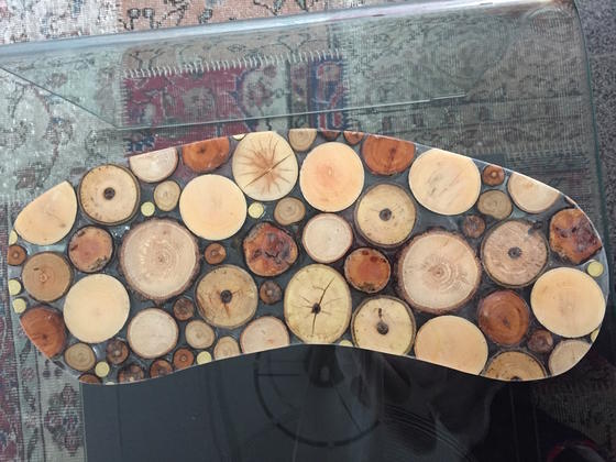

Posts: 12,086
Sunday, January 3rd 2016, 7:43pm
Das meinte ich mit vergießen.
Paladin has attached the following image:
fliege_m
  • "fliege_m" started this thread
Posts: 64
Date of registration: Nov 9th 2015
Thanks: 1
Sunday, January 3rd 2016, 8:21pm
Ahso nein, aber interresant, was ist das ?
